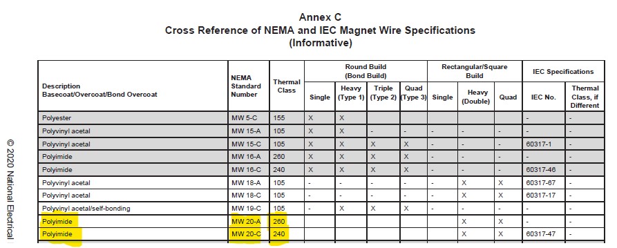

Okanagan
Okanagan
28.03.2022
123
Although I suspect that many vendors don't know or won't tell you, ask for the temperature rating of the magnet wire used to wind the stator. NEMA and IEC have specifications for this. The higher the temperature rating the better. A good temperature rating would be 240C. and the insulation would be polyimide.
