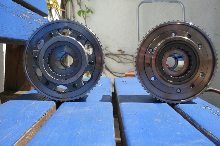

woran kann man erkennen, ob bei einer GS (hier bei mir auch EZ 2011) schon der serienmäßig bessere Startor/LiMa verbaut wurde?

How can you tell whether a GS (mine was also registered in 2011) already has the better standard starter/alternator installed?
You can only tell by looking at the rotor to see if has the additional ventilation holes. To do that you must remove the right side engine cover where the stator resides. The new rotor is on the left in this photo. It was only introduced in the 2013 model year but it could have been retrofitted to your bike.
