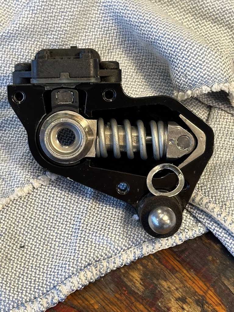

I've been with my GS for a few years now. Generally a pretty perfect bike
The shift assist, when it works, is pretty perfect. Super useful, no banging helmets and goes up and down like butter. Love it.
But, those are the good days. Other days he just refuses to work or works sometime and then jams. Really annoying when you go to tuck your toe under the lever and nothing happens..
This story has been going on for nearly 3 years and now I want a fix....
It has been implied.... the shift unit needs cleaning. So, I removed the middle bolt from the unit and disconnected the gear lever.
Should be able to ease it off and then unplug it....
It seems very very firmly placed on the gear-lever shaft........... Has anyone got any good ideas how to get this off without breaking anything! ....
Some advice and direction would be appreciated. Thank you.

Hi, look at this manual to clean the gear lever
Probleme mit dem Schaltassistent
only cleaning, no grease!
The shift lever should return to its original position without resistance

Well, it turned out to be very easy!. There was washer broken inside of the selector unit!

Solved. This washer was stuck under the shoe on the Right!...

Thank you for the help and interesting links!...... sometimes a problem can be 'that' simple. Nothing got broken or damamged and I sealed the unit up with sealant (a tiny bit of it). Seems fine.
