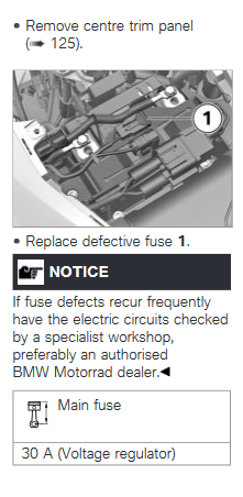

Hello
Main fuse protects the alternator and regulator circuit
shown in the manual page 131

Do you think that the fuse is located in the circuit that leads from the regulator/rectifier to the battery? This is often the case on other bikes.
Something tells me it isn't as simple as that.
